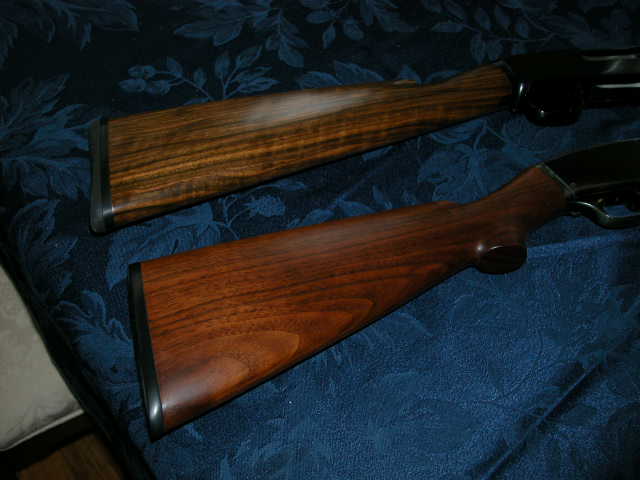

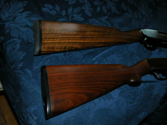

PostPosted: Sat Aug 12, 2006 12:04 am
I don't know. I wouldn't think so, because it hardens rather quickly, and really doesn't penetrate as deeply as you would expect. Ive used it on several electric bass guitars with bolt on necks (no lacquer on these), and 2 acoustic guitars (lacquered headstocks). So far no problems. I only use the bottled Tru oil. The spray stuff appears to be thinned, and I don't like it as well. Buy small bottles as the shelf life is not good once opened.
PostPosted: Sat Aug 12, 2006 2:59 am
Posts: 639
In the 45 years that I have been using it, I don't think I've run into any finish that would be "eaten" by Tru-Oil. Stay away from the spray,though. It does have a solvent in it not present in the liquid. Store the bottle upside down.I recommend sanding it in-thinned 1/3 to 1/2 with ms and letting the slurry fill pores. I have done a detailed post of this someplace or another;just can't remember where. Anyone wanting details-PM and maybe we can set up phone or I'll try to write it up.MT
Miketobey38941.5011921296
